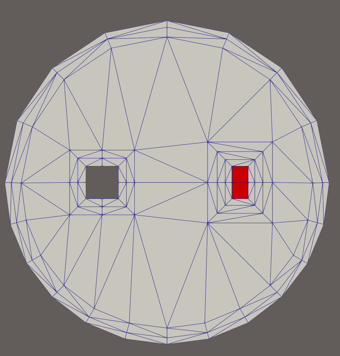

The following example shows how boundary layers can be generated. A boundary layer consisting of two element layers with a bias of 1.5 is generated around the outer boundary. Two boundary layers with different thicknesses, numbers of layers, and biases are generated around the two holes, respectively. One hole mesh is also stitched to the generated mesh. The resulting mesh is shown in Figure 4.
[Mesh<<<{"href": "../../syntax/Mesh/index.html"}>>>]
  [outer_bdy]
    type = ParsedCurveGenerator<<<{"description": "This ParsedCurveGenerator object is designed to generate a mesh of a curve that consists of EDGE2, EDGE3, or EDGE4 elements.", "href": "ParsedCurveGenerator.html"}>>>
    x_formula<<<{"description": "Function expression of x(t)"}>>> = 'r*cos(t)'
    y_formula<<<{"description": "Function expression of y(t)"}>>> = 'r*sin(t)'
    section_bounding_t_values<<<{"description": "The 't' values that bound the sections of the curve. Start and end points must be included. The number of entries in 'nums_segments' should be equal to one less than the number of entries in this parameter."}>>> = '${fparse 0.0} ${fparse pi} ${fparse 2.0*pi}'
    constant_names<<<{"description": "Vector of constants used in the parsed function (use this for kB etc.)"}>>> = 'r'
    constant_expressions<<<{"description": "Vector of values for the constants in constant_names (can be an FParser expression)"}>>> = '1.0'
    nums_segments<<<{"description": "Numbers of segments (EDGE elements) of each section of the curve to be generated. The number of entries in this parameter should be equal to one less than the number of entries in 'section_bounding_t_values'"}>>> = '8 12'
    is_closed_loop<<<{"description": "Whether the curve is closed or not."}>>> = true
  [hole_1]
    type = PolyLineMeshGenerator<<<{"description": "Generates meshes from edges connecting a list of points.", "href": "PolyLineMeshGenerator.html"}>>>
    points<<<{"description": "The points defining the polyline, in order"}>>> = '-0.5 -0.1 0.0
              -0.3 -0.1 0.0
              -0.3 0.1 0.0
              -0.5 0.1 0.0'
    loop<<<{"description": "Whether edges should form a closed loop"}>>> = true
    nums_edges_between_points<<<{"description": "How many Edge elements to build between each point pair. If a single value is given, it is applied to all segments. Otherwise, the number of entries must match the number of segments."}>>> = 2
  [hole_2]
    type = GeneratedMeshGenerator<<<{"description": "Create a line, square, or cube mesh with uniformly spaced or biased elements.", "href": "GeneratedMeshGenerator.html"}>>>
    dim<<<{"description": "The dimension of the mesh to be generated"}>>> = 2
    nx<<<{"description": "Number of elements in the X direction"}>>> = 1
    ny<<<{"description": "Number of elements in the Y direction"}>>> = 2
    xmin<<<{"description": "Lower X Coordinate of the generated mesh"}>>> = 0.4
    xmax<<<{"description": "Upper X Coordinate of the generated mesh"}>>> = 0.5
    ymin<<<{"description": "Lower Y Coordinate of the generated mesh"}>>> = -0.1
    ymax<<<{"description": "Upper Y Coordinate of the generated mesh"}>>> = 0.1
  [xyd]
    type = XYDelaunayGenerator<<<{"description": "Triangulates meshes within boundaries defined by input meshes.", "href": "XYDelaunayGenerator.html"}>>>
    boundary<<<{"description": "The input MeshGenerator defining the output outer boundary and required Steiner points."}>>> = outer_bdy
    outer_boundary_layer_thickness<<<{"description": "Thickness of the outer boundary layer to be added."}>>> = 0.1
    outer_boundary_layer_num<<<{"description": "Number of layers for the outer boundary layer."}>>> = 2
    outer_boundary_layer_bias<<<{"description": "Bias factor for the thickness of each layer in the outer boundary layer."}>>> = 1.5
    holes_boundary_layer_thickness<<<{"description": "Thickness of the hole boundary layers to be added."}>>> = '0.1 0.15'
    holes_boundary_layer_num<<<{"description": "Numbers of layers for the hole boundary layers."}>>> = '2 3'
    holes_boundary_layer_bias<<<{"description": "Bias factors for the thickness of each layer in the hole boundary layers."}>>> = '1.0 1.2'
    refine_boundary<<<{"description": "Whether to allow automatically refining the outer boundary."}>>> = false
    stitch_holes<<<{"description": "Whether to stitch to the mesh defining each hole."}>>> = 'false true'
    refine_holes<<<{"description": "Whether to allow automatically refining each hole boundary."}>>> = 'false false'
    holes<<<{"description": "The MeshGenerators that define mesh holes."}>>> = 'hole_1 hole_2'
    verify_holes<<<{"description": "Verify holes do not intersect boundary or each other.  Asymptotically costly."}>>> = false
    output_subdomain_id<<<{"description": "Subdomain id to set on new triangles."}>>> = 1
    output_subdomain_name<<<{"description": "Subdomain name to set on new triangles."}>>> = 'tri'
(contrib/moose/test/tests/meshgenerators/xy_delaunay_generator/xydelaunay_bdry_layer.i)
Resulting triangulated mesh with boundary layers generated around both the outer boundary and holes.
Figure 4: Resulting triangulated mesh with boundary layers generated around both the outer boundary and holes.
