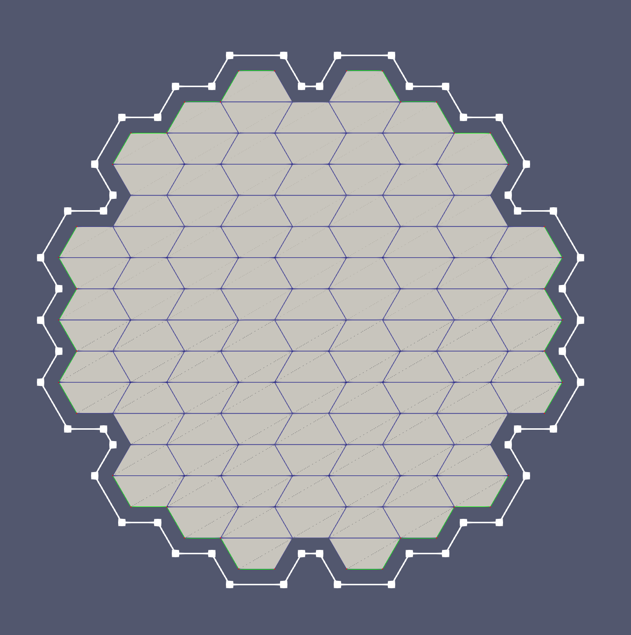

A simple example shown here is based on a set of patterned hexagons. As shown in Figure 1, the generated polyline mesh without refinement only contains one EDGE2 element for each side of the hexagons with a gap from the original hexagons' sides.
A simple non-refined polyline mesh that is generated around set of patterned hexagons, distanced with a gap in the outward direction.
Figure 1: A simple non-refined polyline mesh that is generated around set of patterned hexagons, distanced with a gap in the outward direction.

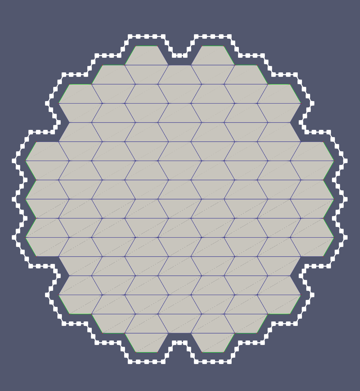

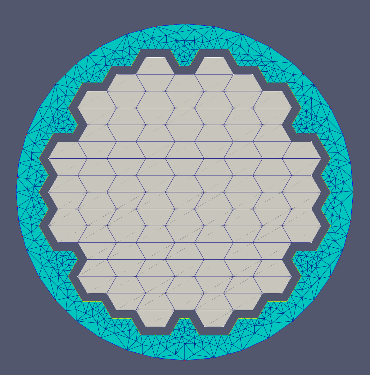

After specifying a maximum element size, additional nodes are inserted along each side of the hexagons to create smaller EDGE2 elements, as shown in Figure 2. Finally, using the refined polyline mesh as input, a triangular mesh with a circular outer boundary is generated by XYDelaunayGenerator as shown in Figure 3.
A refined polyline mesh that is generated around a set of patterned hexagons with a gap in the outward direction.
Figure 2: A refined polyline mesh that is generated around a set of patterned hexagons with a gap in the outward direction.
A triangular mesh that is generated based on the refined polyline mesh ([refined_gap]) and a circular outer boundary.
Figure 3: A triangular mesh that is generated based on the refined polyline mesh (Figure 2) and a circular outer boundary.
