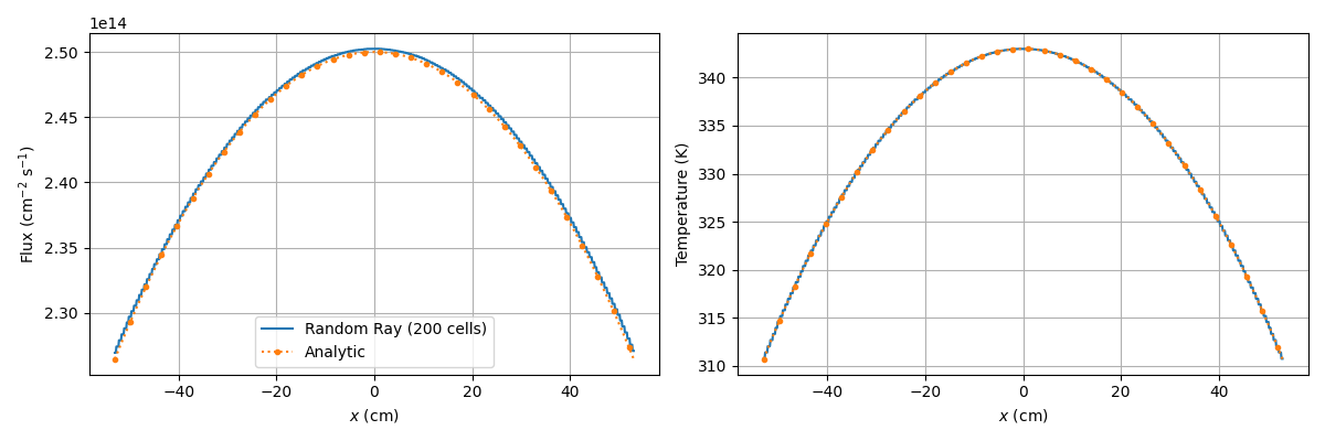

Eltawila et al. (2026) used the Griesheimer and Kooreman benchmark problem to verify Cardinal's thermomechanical-neutronics coupling to OpenMC. Those benchmark results required several small modifications to OpenMC's multi-group Monte Carlo solver to enable S2 neutron transport, precluding the inclusion of input files in Cardinal's regression suite. Readers interested in these results are referred to Eltawila et al. (2026) for more information. Cardinal was found to converge to the analytic solutions with a linear rate of convergence as cells, mesh elements, and temperature grid points were refined. Excellent agreement between Cardinal and the analytic solution was obtained in the case of maximal refinement.

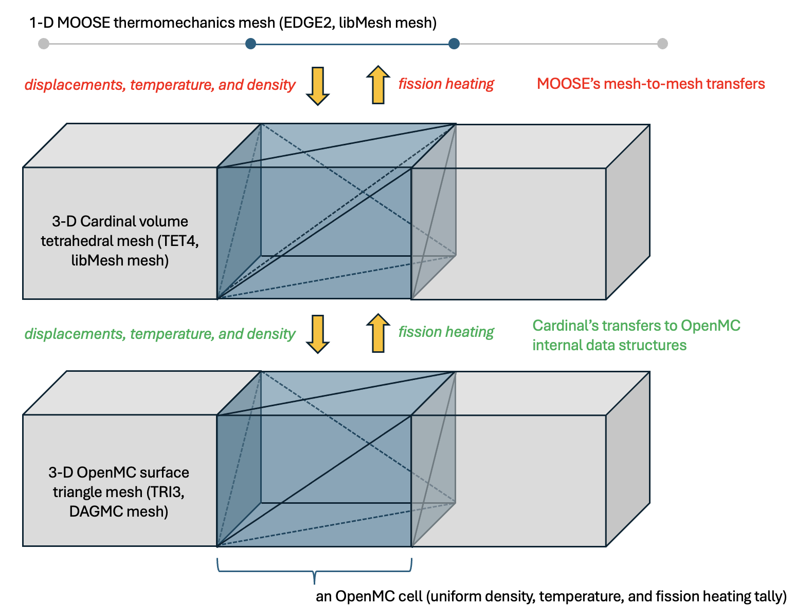

Cardinal is used to couple OpenMC with MOOSE via Picard iteration. OpenMC tallies neutron flux, heating, and the multiplication factor. A conceptual depiction of the meshes used as well as the data transfers that occur on each Picard iteration is shown in Figure 1. Three different meshes/geometries are involved. The thermomechanics mesh is a simple 1D mesh of EDGE2 elements; the thermomechanical physics do not require higher dimensional (e.g. 2D or 3D) meshes for this problem. The OpenMC geometry is represented using DAGMC, where cells are bounded by a triangulated surface (TRI3 elements). To facilitate data transfers between OpenMC and MOOSE thermomechanics, there is also an intermediate volumetric data transfer mesh composed of TET4 elements; no physics solves happen on this intermediate mesh. Figure 1 highlights one element (for MOOSE and the Cardinal intermediate data transfer mesh) and one OpenMC cell each in blue, with adjacent portions of the geometry shown in gray for context.
Data transfers between OpenMC and MOOSE and conceptual depiction of the different meshes used.
Figure 1: Data transfers between OpenMC and MOOSE and conceptual depiction of the different meshes used.

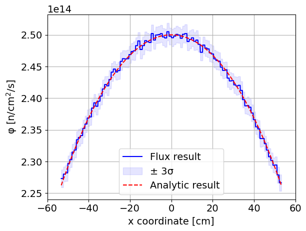

Results
We see the heating result in Figure 2 compared against the analytic solution, as well as flux and temperature solutions in Figure 3 and Figure 4. Figures are only included for eV/s and on a fine mesh where the number of OpenMC and mesh elements is , since all results have a similar shape. Both the heating and flux tally everywhere agree with the analytic solution within 3.
Heating result from OpenMC for N = 100 mesh elements compared against the analytic solution.
Figure 2: Heating result from OpenMC for N = 100 mesh elements compared against the analytic solution.
Flux result from OpenMC for N = 100 mesh elements compared against the analytic solution.
Figure 3: Flux result from OpenMC for N = 100 mesh elements compared against the analytic solution.

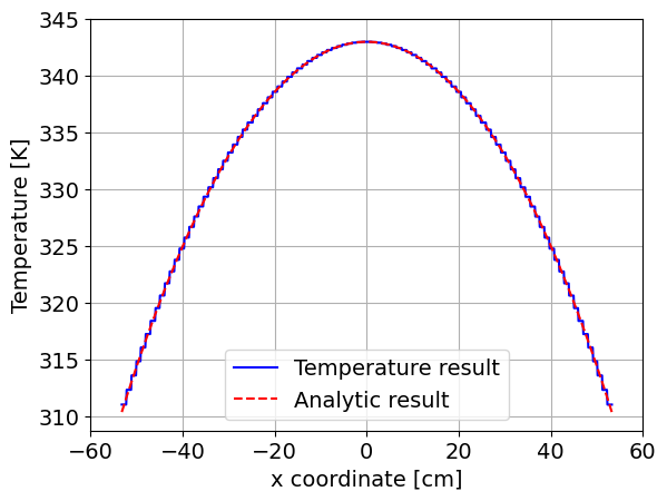

Temperature result from MOOSE for N = 100 mesh elements compared against the analytic solution.
Figure 4: Temperature result from MOOSE for N = 100 mesh elements compared against the analytic solution.
Table 2 shows results convergence with mesh refinement.
Table 2: Results and corresponding errors with different mesh sizes (Eltawila et al., 2026).
ResolutionHeated length (cm)Error (μm)Error (pcm)
Analytic solution106.47–0.29557–
5106.3298-14020.29608 ± 0.0000151 ± 1
10106.4382-3180.29619 ± 0.0000162 ± 1
20106.4671-290.29557 ± 0.000010 ± 1
50106.4730300.29536 ± 0.00001-21 ± 1
100106.4745450.29549 ± 0.00001-8 ± 1
200106.4748480.29556 ± 0.00001-1 ± 1

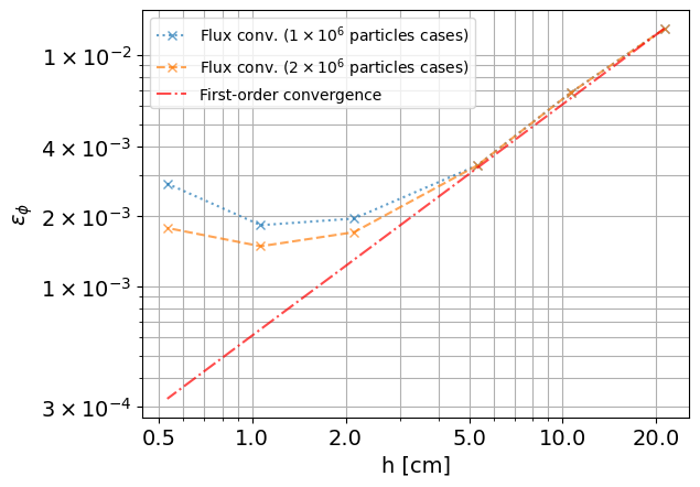

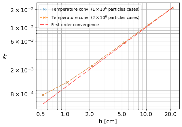

In Figure 5 and Figure 6, convergence of flux and temperature relative L norms, defined as
and
where is the analytic flux solution, is the Cardinal flux solution, is the analytic temperature solution, and is the Cardinal temperature solution.
Convergence of flux relative L$^2$ norm.
Figure 5: Convergence of flux relative L norm.
Convergence of temperature relative L$^2$ norm.
Figure 6: Convergence of temperature relative L norm.
A first-order convergence of the temperature is achieved with mesh refinement, while the flux starts to converge following a first-order trend then stagnates where other error components dominate as discussed earlier. The stochastic noise error influence is highlighted by keeping the number of particles constant for each line, where we see further convergence when there is less stochastic noise.
We hypothesize that the observed first-order convergence arises from the use of cell tallies in OpenMC, where heating results are tallied as constant monomials. This may be limiting the convergence rate of the coupled solve.

Scalar flux and temperature distributions predicted with [!ac](TRRM) in Cardinal.
Figure 7: Scalar flux and temperature distributions predicted with TRRM in Cardinal.
The impact of the y-z induced source region gradients can be seen in the flux solution, resulting in reasonable (but not perfect) agreement with Eq. (14). The thermomechanics problem uses a true 1D mesh, resulting in better agreement between the numerical temperature predictions and Eq. (15). The TRRM solution predicts ( pcm) and an expanded slab length cm. It is expected that the agreement in both the flux and eigenvalue solutions will improve when hexahedral element support is added to the MoabSkinner in issue #1352,as this will eliminate the y-z source region gradients in the TRRM solution.
The input files for the TRRM solutions to the Griesheimer and Kooreman problem can be found in /test/tests/neutronics/mg/rr_thermal_expansion, where they are used to regression test on-the-fly skinning with TRRM. Please note that these input files have been modified to run a 20 cell mesh, with fewer Picard iterations and rays per batch to reduce the computational requirements of the test.
