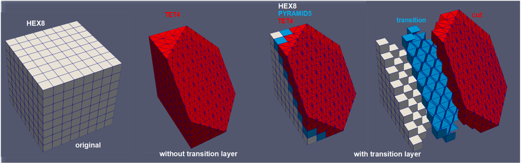

Example of cutting a cube mesh consisting of `HEX8` elements along a plane. From left to right: (1) original mesh; (2) mesh after the cutting without the transition layer; (3) mesh after the cutting with the transition layer; (4) detailed breakdown of the mesh cut with the transition layer.
Figure 1: Example of cutting a cube mesh consisting of HEX8 elements along a plane. From left to right: (1) original mesh; (2) mesh after the cutting without the transition layer; (3) mesh after the cutting with the transition layer; (4) detailed breakdown of the mesh cut with the transition layer.
Method 1: Full Conversion to TET4 Elements
This method converts all elements of the input mesh into TET4 elements. The conversion is performed using the ElementsToTetrahedronsConverter algorithm, which splits non-TET4 elements into TET4 elements. Note that only those elements that will be fully or partially retained after the cutting are split.
As all the non-TET4 elements are converted into TET4 elements, the output mesh only contains TET4 elements. Thus, all the subdomain ids and names of the input mesh are preserved in the output mesh. See the second subfigure in Figure 1 for an example.
Method 2: Transition Layer Approach
The transition layer approach utilizes an algorithm that is similar to what is described in BoundaryElementConversionGenerator. In this method, only the elements that are crossed by the cutting plane are converted into TET4 elements (using the ElementsToTetrahedronsConverter algorithm). The elements that are adjacent to these converted TET4 elements are also converted into a combination of TET4 and PYRAMID5 elements, which are then used to create a transition layer between the TET4 elements and the original elements. In this case, the majority of elements in the input mesh can be retained as they are. This option can be enabled by setting "generate_transition_layer" to true. See the third and fourth subfigures in Figure 1 for an example.
As new types of elements are introduced in the transition layer, only the subdomain ids and names of the input mesh that are associated with the retained elements are preserved in the output mesh. The new TET4 and PYRAMID5 elements in the transition layer are assigned new subdomain names that are based on the original subdomain names with a suffix defined by "converted_pyramid_element_subdomain_name_suffix" and "converted_tet_element_subdomain_name_suffix", respectively. The new subdomain ids are assigned by automatically shifting the original ids.
