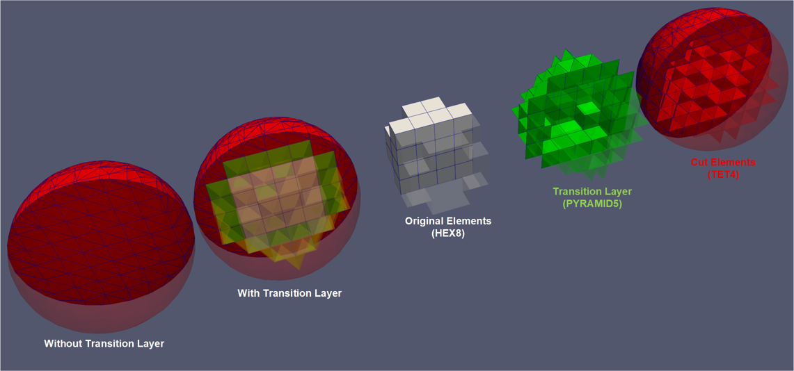

Example of cutting a cube mesh consisting of `HEX8` elements using a spherical level set. From left to right: (1) mesh after the cutting without the transition layer; (2) mesh after the cutting with the transition layer; (3-5) detailed breakdown of the mesh cut with the transition layer.
Figure 1: Example of cutting a cube mesh consisting of HEX8 elements using a spherical level set. From left to right: (1) mesh after the cutting without the transition layer; (2) mesh after the cutting with the transition layer; (3-5) detailed breakdown of the mesh cut with the transition layer.
CutMeshByLevelSetGenerator first either converts all elements of the input mesh into TET4 elements, or converts the elements crossed by the level set into TET4 elements along with a transition layer that consists of TET4 and PYRAMID5 elements. Next, the TET4 elements sliced by the level set are further split into TET4 elements.
This mesh generator uses exactly the same algorithm as its sibling mesh generator, CutMeshByPlaneGenerator. At the first-order element level, cutting by a plane and cutting by a level set are the same. See Figure 1 for an example. Refer to CutMeshByPlaneGenerator for advanced options and details.
