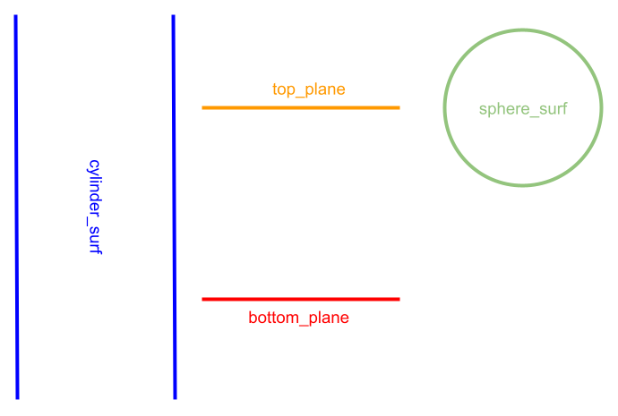

The following is an example of using a combination of all operators to define the space outside a cylinder of a finite height that is topped with a half-sphere. Each of the half-spaces associated with each surface are shown in Figure 1. The cylinder and planes are then combined via intersection to form the region inside a finite cylinder, and the space above the top plane is intersected with the sphere to define a half sphere (Figure 2). These two regions are unionized as shown in Figure 3. The complement of the previous combination then defines the final region ~((-cylinder_surf & -top_plane & +bottom_plane) | (+top_plane & -sphere_surf)), as shown in blue in Figure 4.
Four different surfaces: an infinite cylinder (blue), a top plane (orange), a bottom plane (red), and a sphere (green)
Figure 1: Four different surfaces: an infinite cylinder (blue), a top plane (orange), a bottom plane (red), and a sphere (green)

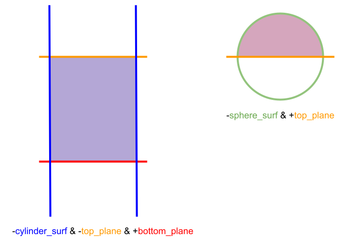

Two separate regions both defined as *intersections* of *half-spaces*.
Figure 2: Two separate regions both defined as intersections of half-spaces.
One region defined by the *union* of two other regions.
Figure 3: One region defined by the union of two other regions.

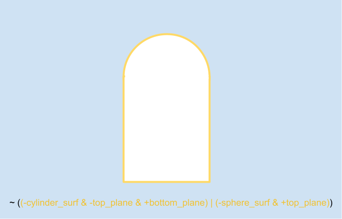

A region defined as the *complement* of an existing region.
Figure 4: A region defined as the complement of an existing region.

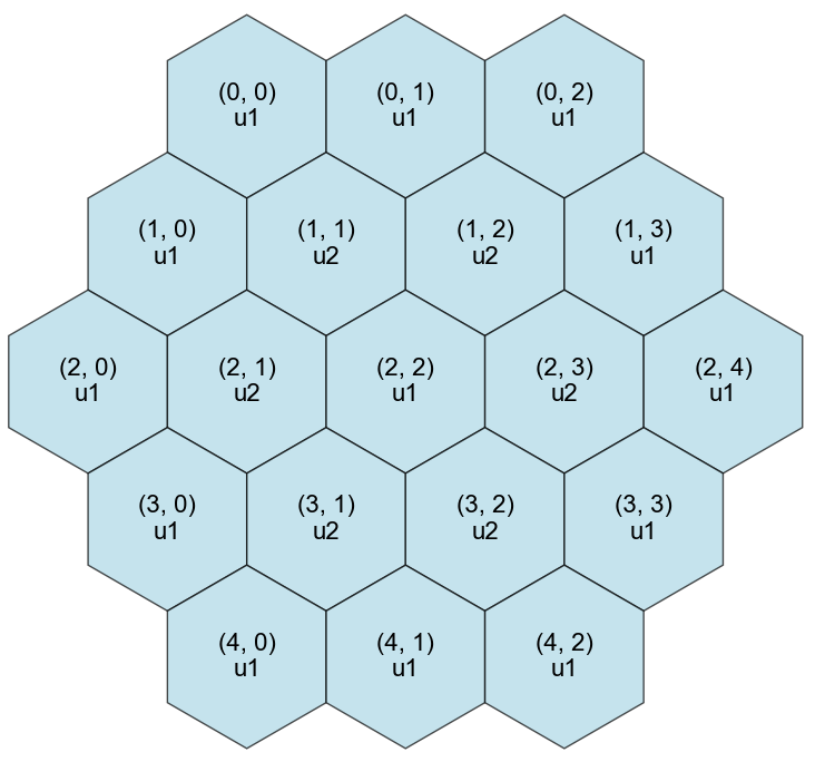

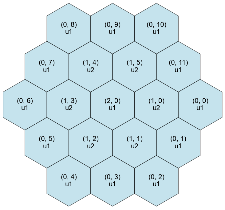

The CSGBase class provides support for two types of 2D lattice types (Cartesian and regular hexagonal), but any custom lattice type can also be defined by following the information in CSGLattice. It is assumed that both the Cartesian and hexagonal lattice types are in the plane (having a normal). Three types of outer fill are supported: void (default), material (an std::string name), and CSGUniverse. For both lattice types, the lattice can be initialized minimally with a name and pitch (the flat-to-flat size of a lattice element). The pattern of universes can also be set at the time of initialization or updated later using the setLatticeUniverses method. And similarly, the outer fill (either a CSGUniverse object or an std::string representing the name of a material) can be set at the time of initialization or set later with the setLatticeOuter method; if the outer is not set, it is assumed to be VOID. Some examples of initializing a lattice with the various options are shown below.
    // initialize without universe map, outer is void, and pitch=1.0
    auto cart_lattice = CSGCartesianLattice("cartlat", 1.0);
(contrib/moose/unit/src/CSGLatticeTest.C)
    // initialize with universe map and set outer fill to be a universe
    auto cart_lattice = CSGCartesianLattice("cartlat", 1.0, univ_map, outer_univ);
    // initialize without universe map but set outer to a material
    auto cart_lattice = CSGCartesianLattice("cartlat", 1.0, "outer_mat");
commentnote:2D vs. 3D Lattices
The CSGBase class supports only the creation of 2D lattices. A "3D" lattice can be created by filling multiple 3D cells with 2D lattices and arranging them in layers to form the desired 3D structure.

Both the Cartesian and hexagonal lattice types follow a row-column indexing scheme for the location of universes in the lattice.
For Cartesian lattices, there can be any number of rows and columns, but each row must be the same length. The indexing starts at the top left corner of the lattice with element . An example of the indices for a Cartesian lattice is shown in Figure 5.
Example of a $2 \times 3$ Cartesian lattice and the corresponding location indices.
Figure 5: Example of a Cartesian lattice and the corresponding location indices.
For hexagonal lattices, the lattice is assumed to be x-oriented and also uses the row-column indexing scheme, with element being the top row, leftmost element. The length of the rows is expected to be consistent with the size of the lattice (i.e., the number of rings), which is verified when the universes are set. An example of the indices for a 3-ring hexagonal lattice is shown in Figure 6.
Example of a 3-ring hexagonal lattice that has the location indices labeled in the $(i, j)$ form.
Figure 6: Example of a 3-ring hexagonal lattice that has the location indices labeled in the form.
commentnote:Y-Oriented Hexagonal Lattices
The CSGHexagonalLattice class assumes an x-oriented lattice layout. To define a y-oriented lattice, the recommendation is to first define an x-oriented lattice and apply a rotation transformation. All indexing in this case will still remain consistent with the x-oriented indexing as described below.
Convenience methods are provided for CSGHexagonalLattice objects to convert between the required indices and a ring-based indexing scheme. In the ring-based scheme, the outermost ring is the 0th ring, and the right-most element in the ring is the 0th position of the ring with indices increasing counter-clockwise around the ring. For the 3-ring lattice above in Figure 6, the corresponding indices would be as shown in Figure 7.
Example of a 3-ring hexagonal lattice that has the location indices labeled in the $(r, p)$ form.
Figure 7: Example of a 3-ring hexagonal lattice that has the location indices labeled in the form.
For any lattice, the index of a universe in the lattice can be retrieved from the index by calling the getRingIndexFromRowIndex method. And similarly, if the index form is known, the corresponding index can be retrieved using the getRowIndexFromRingIndex method. It is important to note that while these convenience methods exist to convert between the two indexing schemes, the CSGUniverse objects in the lattice can only be accessed using the index.
