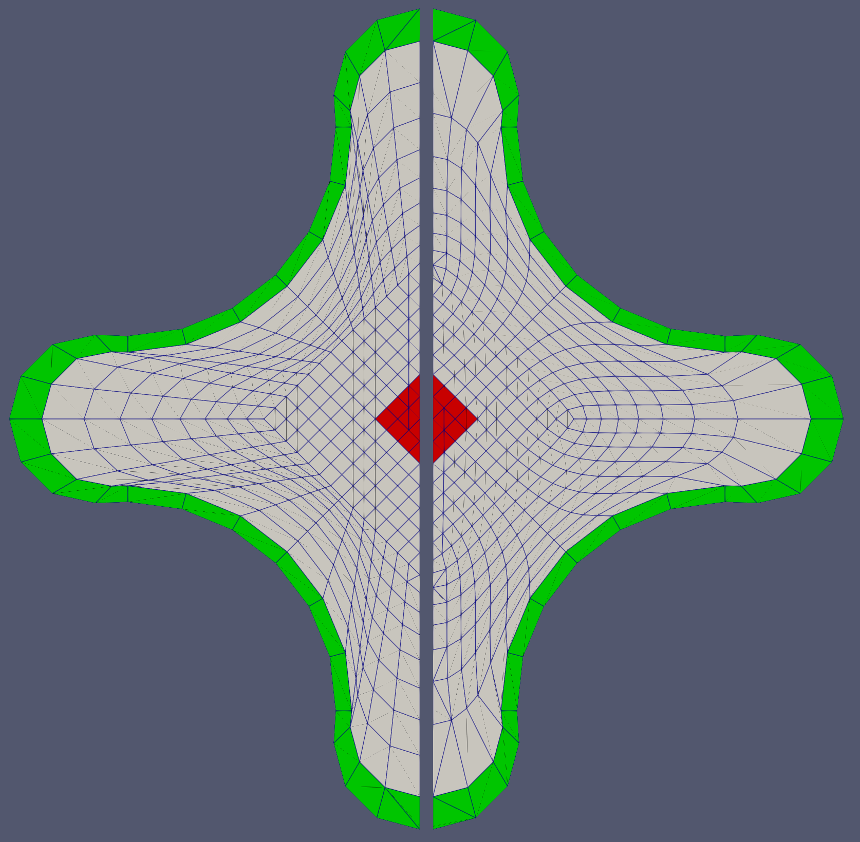

Example 2 — Variational smoothing (fixed boundary nodes)
Here is an example of the variational smoother applied to a mesh with 3 subdomains and nonlinear boundaries. Note that the locations of the (subdomain) boundary nodes do not change.

Variational smoother applied to mesh with nonlinear boundary. The original mesh is shown on the left and the smoothed mesh is shown on the right.
Figure 2: Variational smoother applied to mesh with nonlinear boundary. The original mesh is shown on the left and the smoothed mesh is shown on the right.

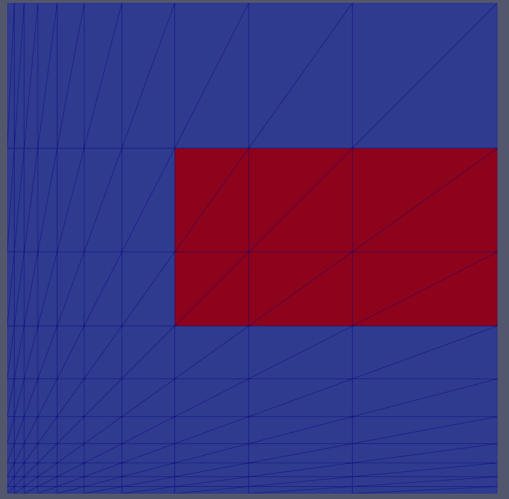

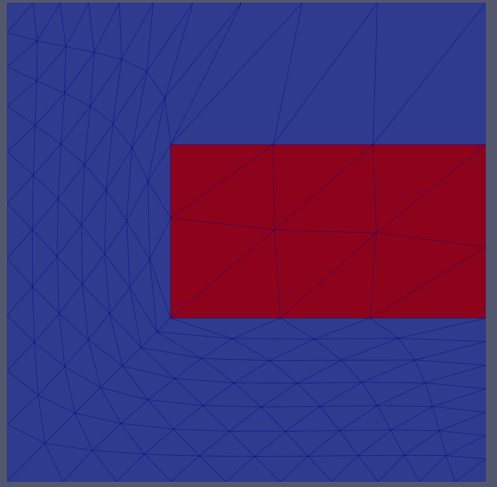

Example 3 — Variational smoothing (sliding boundary nodes)
Here is an example of the variational smoother applied to a mesh with 2 subdomains and linear boundaries. Note that while the locations of the (subdomain) boundary nodes change, these boundaries are still preserved.

Original mesh.
Figure 3: Original mesh.
