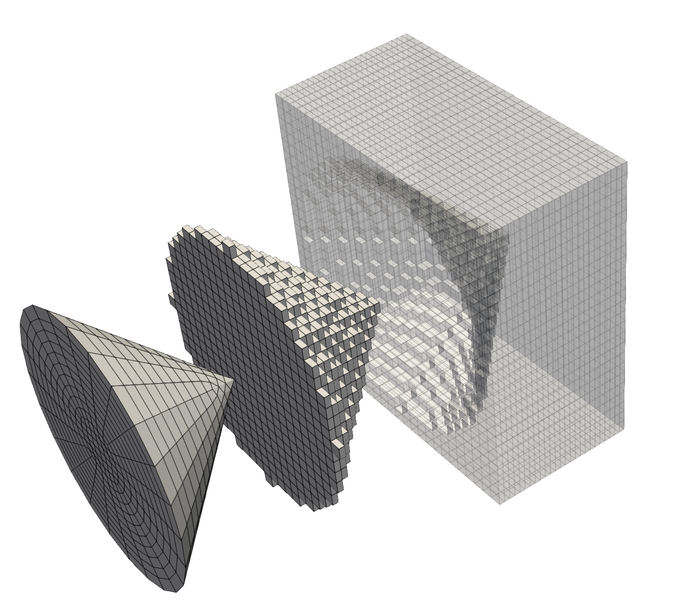

Voxelizing Surface Meshes
Another use case for this mesh generator is to voxelize a geometry defined by a surface. This is useful when tetrahedralization via XYZDelaunayGenerator may not produce a desired mesh, and representing the geometry perfectly is not important. This is useful for simulations, like fluid dynamics, where tetrahedrals are not desired for the simulation. The idea is to create an "easy" volumetric mesh, i.e. a structured grid, and remove elements inside or outside of the manifold. Below is an example of creating a manifold of a cone and voxelizing using a structured grid.

(contrib/moose/test/tests/meshgenerators/manifold_subdomain/cone.i)
Note that ElementsToSimplicesConverter is used to convert the QUAD elements of the original surface to TRI elements, required by this generator. One can voxelize either the inside or outside of the manifold with the "location" parameter. The figure below show the resulting volumetric meshes.
Voxelizing a cone using ManifoldSubdomainGenerator. Left is the     manifold surface mesh, center the resulting voxelization of the cone, and     right is the resulting voxelization of the space around the cone.
