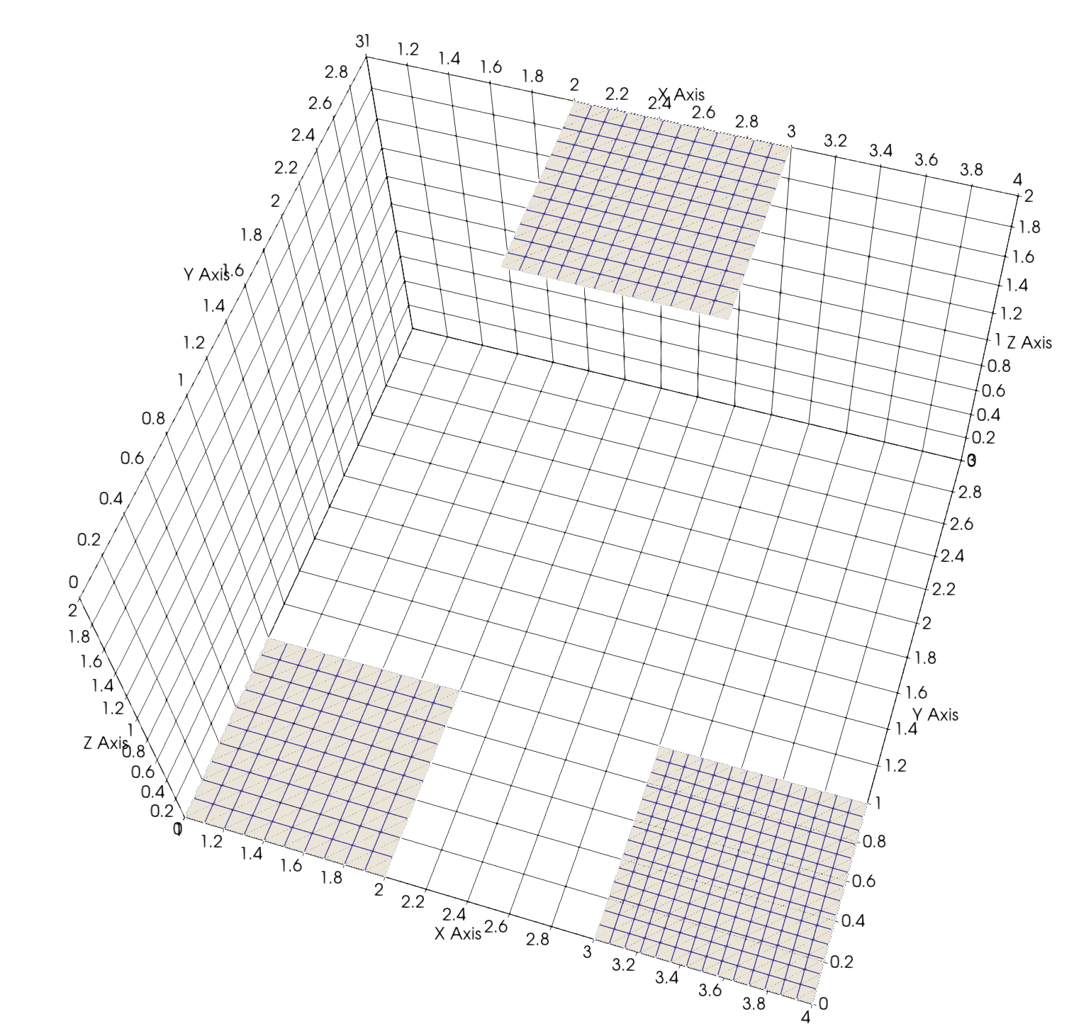

Will generate a mesh that looks like:
Three copies of the same mesh, each translated in space.
