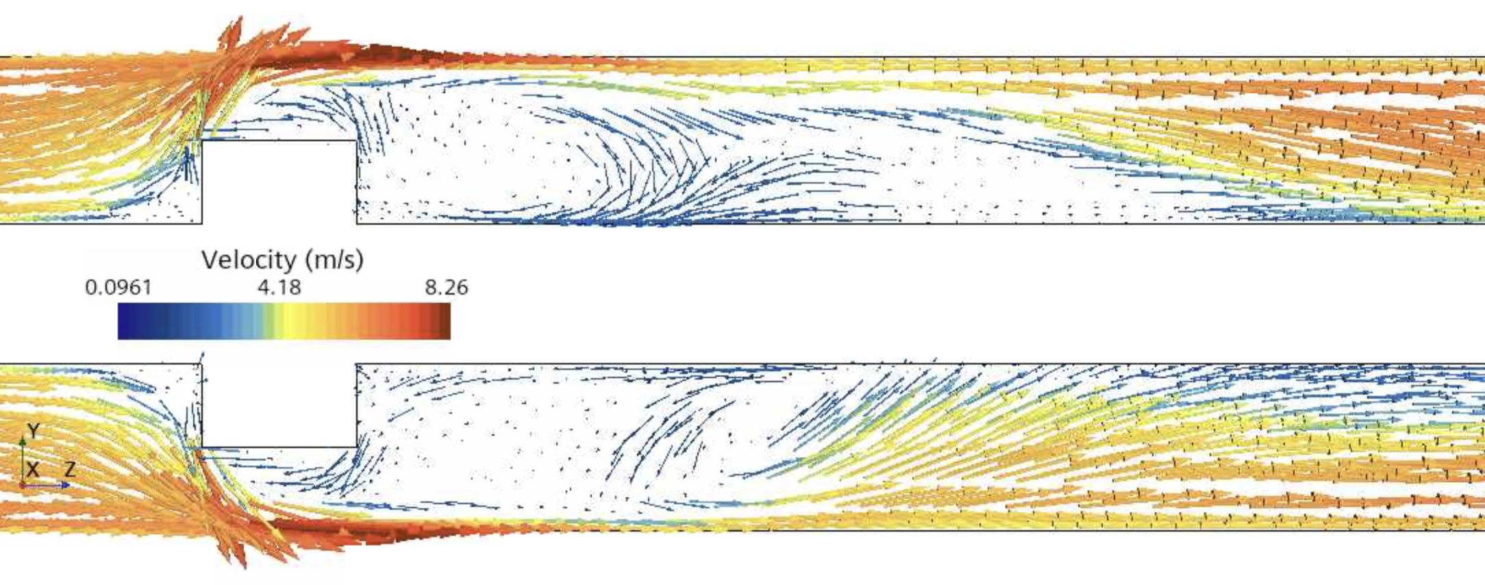

A CFD model was developed to use as a reference solution and to further evaluate SCM's performance. The CFD model had about 1 million cells and utilized an implicit unsteady transient solver. Segregated fluid and energy solvers, turbulence modeling and the default polyhedral STAR-CCM+ mesher were used. Figure 5,Figure 6 and Figure 7 present the CFD simulation results on a 2D plane around the blockage location.
CFD velocity vector field.
Figure 5: CFD velocity vector field.
