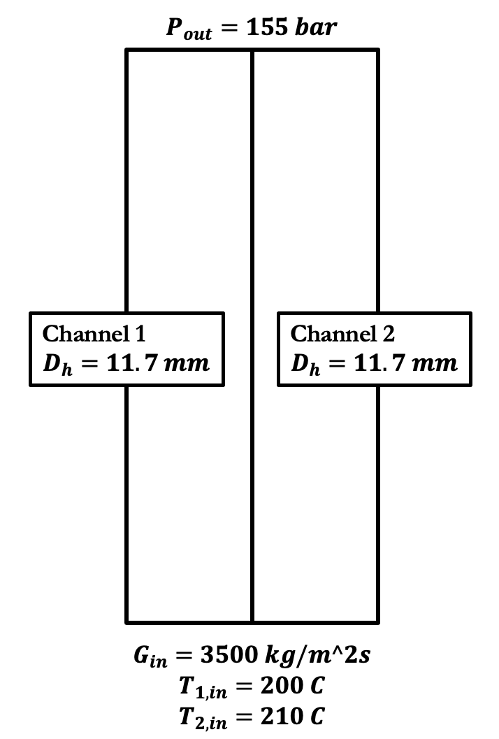

This verification problem is the same used in Robert Salko and Avramova (2015). This case presents a problem where the effects of turbulent mixing are clearly discernible and quantifiable. Turbulence causes both momentum and enthalpy mixing through the terms:
Because the model for turbulent mixing is gradient-driven based in , in order to observe the effects of turbulence, it is necessary to make a gradient in either energy or momentum. It is easier to focus on the energy equation and deactivate the density calculation. The problem geometry consists of two identical channels connected by a gap and is seen in Figure 1.
Enthalpy mixing model verification problem geometry
Figure 1: Enthalpy mixing model verification problem geometry
To test the turbulent mixing model, the temperature of one channel is raised by 10 degrees Celsius. Turbulent enthalpy mixing will transfer heat from the hot channel to the cold channel. The solution given by the code is then compared to the analytical solution:
