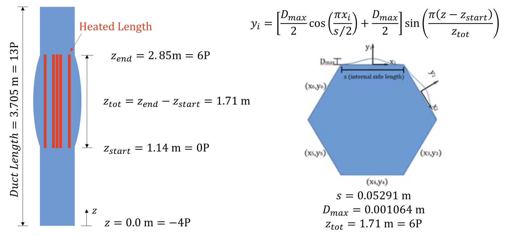

SCM duct deformation model
SCM models the effect of the deformation of the duct by adapting the geometric parameters of the perimetric subchannels according to a representative per subchannel deformation variable, which is called Displacement (D). This displacement variable is calculated based on the centroid coordinates of each subchannel. Particularly, the relative lateral location of the subchannel centroid in relation to the center of each deformed duct side () and the height (). These values are plugged into the equation that describes the deformation, which is presented in Figure 2. The result is the value of Displacement D for each subchannel at a specific axial height.
The geometric parameters affected by displacement D are the wetted perimeter, the gap, and the surface area. This consequently leads to a change in the hydraulic diameter, friction factor, and friction force, among others, which, in turn, have an effect on the resolved flow field via the conservation of momentum equations. The effect of the displacement value on the geometric parameters is graphically presented in Figure 3.
SCM duct deformation modeling.
Figure 3: SCM duct deformation modeling.
The green line at the top of Figure 3 represents an exaggerated version of the deformation. Based on the centroid location (black circles), the value of the displacement variable is calculated. This calculation is performed per subchannel and the result of this calculation is used to perturb the other geometric parameters. A different treatment is used for the side and corner subchannels.
For the side subchannels, located in the perimeter of the hexagonal assembly, only the surface area and the gap between the pins and the duct are affected by the duct deformation. The wetted perimeter remains the same. The deformation is assumed constant along the side of the subchannel and a rectangular (blue-shaded) shaped area is added to the original surface area of the subchannel. This is an approximation since the actual deformation has the shape depicted in Figure 2 and the green line in Figure 3.
For the corner subchannel the surface area, gap, and wetted perimeter are affected. In this case a lambda (blue-shaded) shaped area is added to the original surface area subchannel. Again, this is an approximation necessitated by the fact that in the subchannel formulation all values are considered in a per subchannel basis. The deformation is assumed to be symmetric across the line connecting the center of the corner pin to the corner of the duct.
Alternatively, the user can opt to create custom ICs to directly define the geometric parameters: surface area and wetted perimeter for the deformed edge/corner subchannels.
