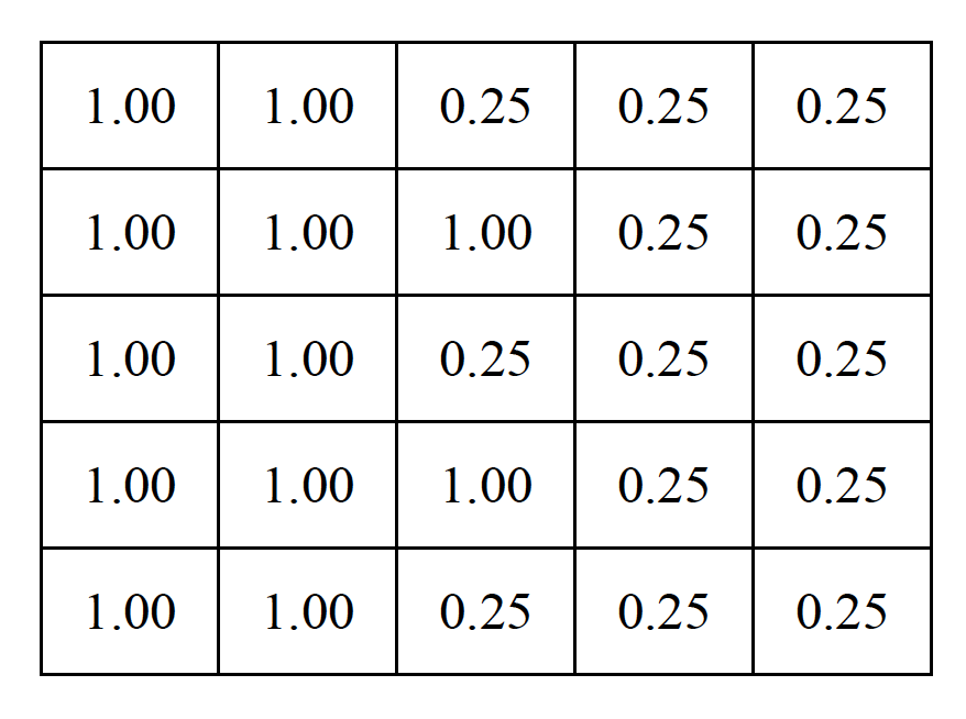

The pin bundle has a radial power profile in which the right side of the assembly is under-heated. The radial power profile is shown in Figure 1. The pins on the left side transfer 100% of available pin power to the fluid, while the pins on the right transfer 25%. This causes an uneven temperature distribution at the exit of the assembly.
Radial pin power profile
Figure 1: Radial pin power profile
