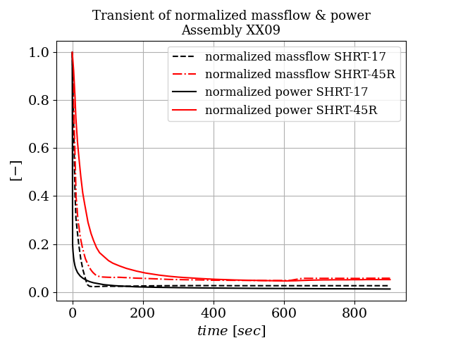

During the SHRT transients, the mass flow rate and power vary. The normalized power and mass flow rate during the transients have been taken from Mochizuki et al. (2014) , Mochizuki and Muranaka (2018) and are presented in Figure 4. This information is used as input for the SCM transient calculations. The work in the cited sources utilizes a NETFLOW++ Mochizuki (2010) simulation to inform a COBRA-IV-I Wheeler et al. (1976) model of the instrumented sub-assembly XX09. It should be noted that for SHRT-17, the power generation throughout the transient is solely due to decay heat because the protection system shuts down the reactor. For the SHRT-45R test, fission power continues into the transient for some time until the reactivity feedback mechanisms ultimately shut down the reactor.
Transient boundary conditions
Figure 4: Transient boundary conditions

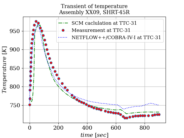

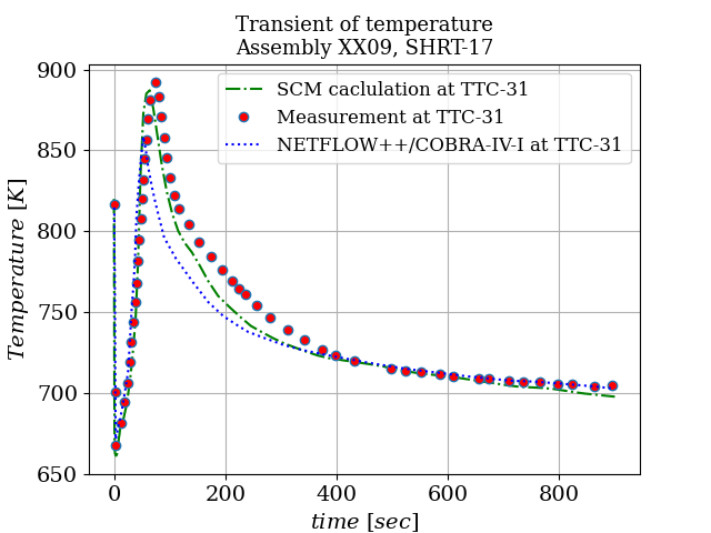

Transient Results
Simulations with uniform power profile are performed with the SCM model. Results are compared against experimental measurements and the NETFLOW++/COBRA simulations are used as a reference result. The temperature transient calculations, together with the experimental measurements at thermocouple location TTC-31, are presented in Figure 7,Figure 8. In SHRT-17, the power of the XX09 sub-assembly decreases rapidly at time zero due to the reactor scram, which results in a sudden coolant temperature decrease. On the other hand, in SHRT-45R there is no scram of the reactor, so power decreases at a much lower pace. This is why no sudden temperature drop is observed at time zero.
Then for both tests, the flow rate gradually decreases due to the pump trip and coasts-down, causing the coolant temperature to increase to a peak of around for SHRT-17 and for SHRT-45R. Following that, the coolant temperature decreases and levels off to for SHRT-17 and for SHRT-45R with the establishment of natural circulation due to decay heat and buoyancy effects.
For both SHRT-17 and SHRT-45R, the stand-alone SCM calculated transient, underestimates the measured result of the peak temperature, by approximately . The thermal inertia of the solid structures play an important role in determining the temperature field transient, towards the establishment of natural convection. As these structures are not modeled in the SCM simulations, a more rapid decrease in the temperature field is observed in the computed cases. Nonetheless, the thermal inertia of these structures does not play a fundamental role once natural convection is established, as the system is in thermal equilibrium. Hence, better agreement is obtained for this part of the transient. In general, good results are obtained for both transients, with the SCM being in better agreement with the experiment compared to the NETFLOW++/COBRA simulations.
Test SHRT-17
Figure 7: Test SHRT-17
Test SHRT-45R
Figure 8: Test SHRT-45R

The Functions block defines the shape of the axial power profile:
[Functions<<<{"href": "../../../syntax/Functions/index.html"}>>>]
  [axial_heat_rate]
    type = ParsedFunction<<<{"description": "Function created by parsing a string", "href": "../../../source/functions/MooseParsedFunction.html"}>>>
    expression<<<{"description": "The user defined function."}>>> = '(pi/2)*sin(pi*z/L)*exp(-alpha*z)/(1.0/alpha*(1.0 - exp(-alpha*L)))*L'
    symbol_names<<<{"description": "Symbols (excluding t,x,y,z) that are bound to the values provided by the corresponding items in the symbol_values vector."}>>> = 'L alpha'
    symbol_values<<<{"description": "Constant numeric values, postprocessor names, function names, and scalar variables corresponding to the symbols in symbol_names."}>>> = '${heated_length} 1.8012'
(contrib/moose/modules/subchannel/validation/EBR-II/XX09_SCM_SS17.i)
Transient BC's
For the transient case the user needs to provide transient boundary conditions:
  • First define the initial power and the power history field along with the default variable q_prime, in the AuxVariables block
  [q_prime_init]
    block = fuel_pins
  [power_history_field]
    block = fuel_pins
  [q_prime]
    block = fuel_pins
  • Then, define the transient evolution of the boundary conditions in the Functions block based on .csv files:
  [power_func]
    type = PiecewiseLinear<<<{"description": "Linearly interpolates between pairs of x-y data", "href": "../../../source/functions/PiecewiseLinear.html"}>>>
    data_file<<<{"description": "File holding CSV data"}>>> = 'power_history_SHRT17.csv'
    format<<<{"description": "Format of csv data file that is in either in columns or rows"}>>> = "columns"
    scale_factor<<<{"description": "Scale factor to be applied to the output values"}>>> = 1.0
  [mass_flux_in]
    data_file<<<{"description": "File holding CSV data"}>>> = 'massflow_SHRT17.csv'
    scale_factor<<<{"description": "Scale factor to be applied to the output values"}>>> = '${fparse mass_flux_in / 2.45}'
  [time_step_limiting]
    xy_data<<<{"description": "All function data, supplied in abscissa, ordinate pairs"}>>> = '0.1 0.1
               10.0 10.0'
(contrib/moose/modules/subchannel/validation/EBR-II/XX09_SCM_TR17.i)
  • The functions defined above are given normalized and they multiply the initial steady state conditions:
[Controls<<<{"href": "../../../syntax/Controls/index.html"}>>>]
  [mass_flux_ctrl]
    type = RealFunctionControl<<<{"description": "Sets the value of a 'Real' input parameters to the value of a provided function.", "href": "../../../source/controls/RealFunctionControl.html"}>>>
    parameter<<<{"description": "The input parameter(s) to control. Specify a single parameter name and all parameters in all objects matching the name will be updated"}>>> = 'Postprocessors/mass_flux_PP/value'
    function<<<{"description": "The function to use for controlling the specified parameter."}>>> = 'mass_flux_in'
    execute_on<<<{"description": "The list of flag(s) indicating when this object should be executed. For a description of each flag, see https://mooseframework.inl.gov/source/interfaces/SetupInterface.html."}>>> = 'initial timestep_begin'
