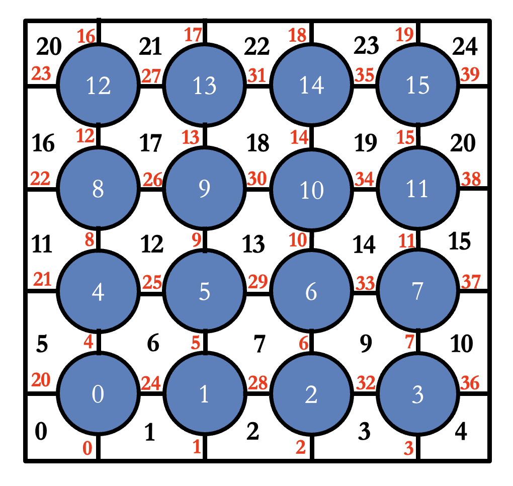

Square lattice
Square Lattice subchannel index notation, in a $5 \times 5$ sub-assembly.
Figure 1: Square Lattice subchannel index notation, in a sub-assembly.

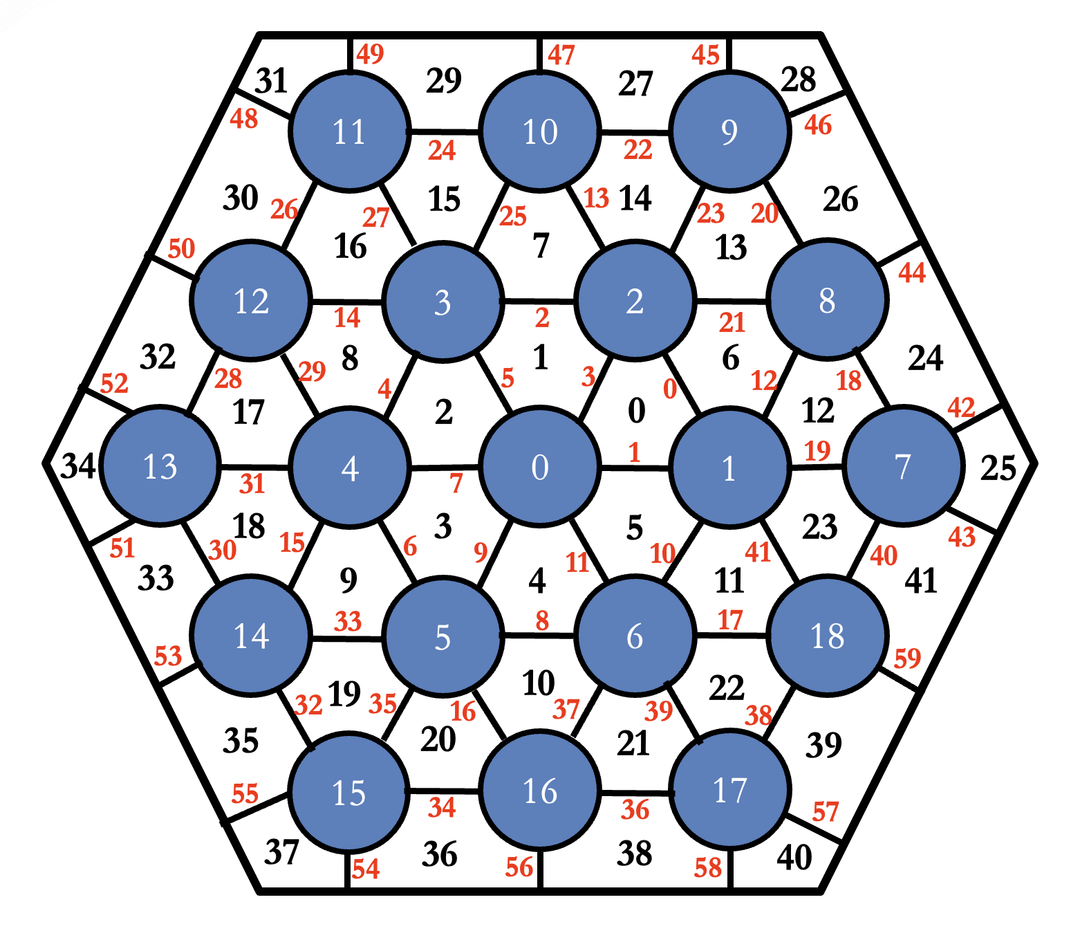

Triangular lattice
Triangular Lattice subchannel index notation, in a $3$ ring sub-assemly.
Figure 2: Triangular Lattice subchannel index notation, in a ring sub-assemly.
In order for the user to print the index notation for subchannels and pins in a triangualar lattice arrangement, they are invited to run the following Python script:
