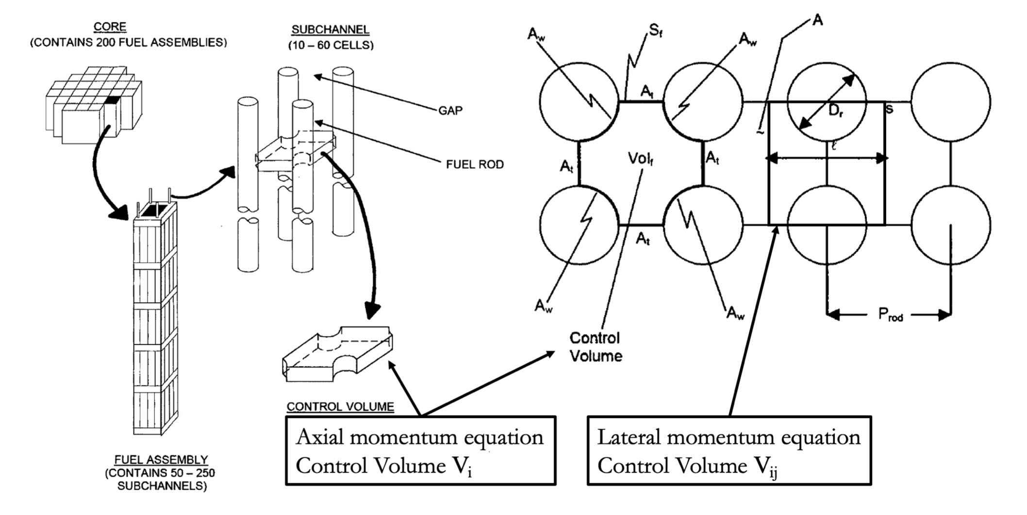

The subchannel thermal-hydraulic analysis is based on the conservation equations of mass, linear momentum and energy on the specified control volumes. The control volumes are connected in both axial and radial directions to capture the three dimensional effects of the flow geometry. The subchannel control volumes are shown in Figure 1 from Todreas et al. (2021).
Square Lattice subchannel control volume
Figure 1: Square Lattice subchannel control volume
The subchannel equations are derived by integrating and averaging the conservation equations over the subchannel control volumes.

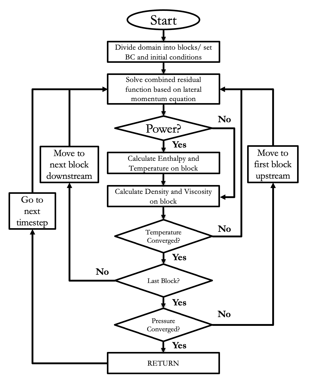

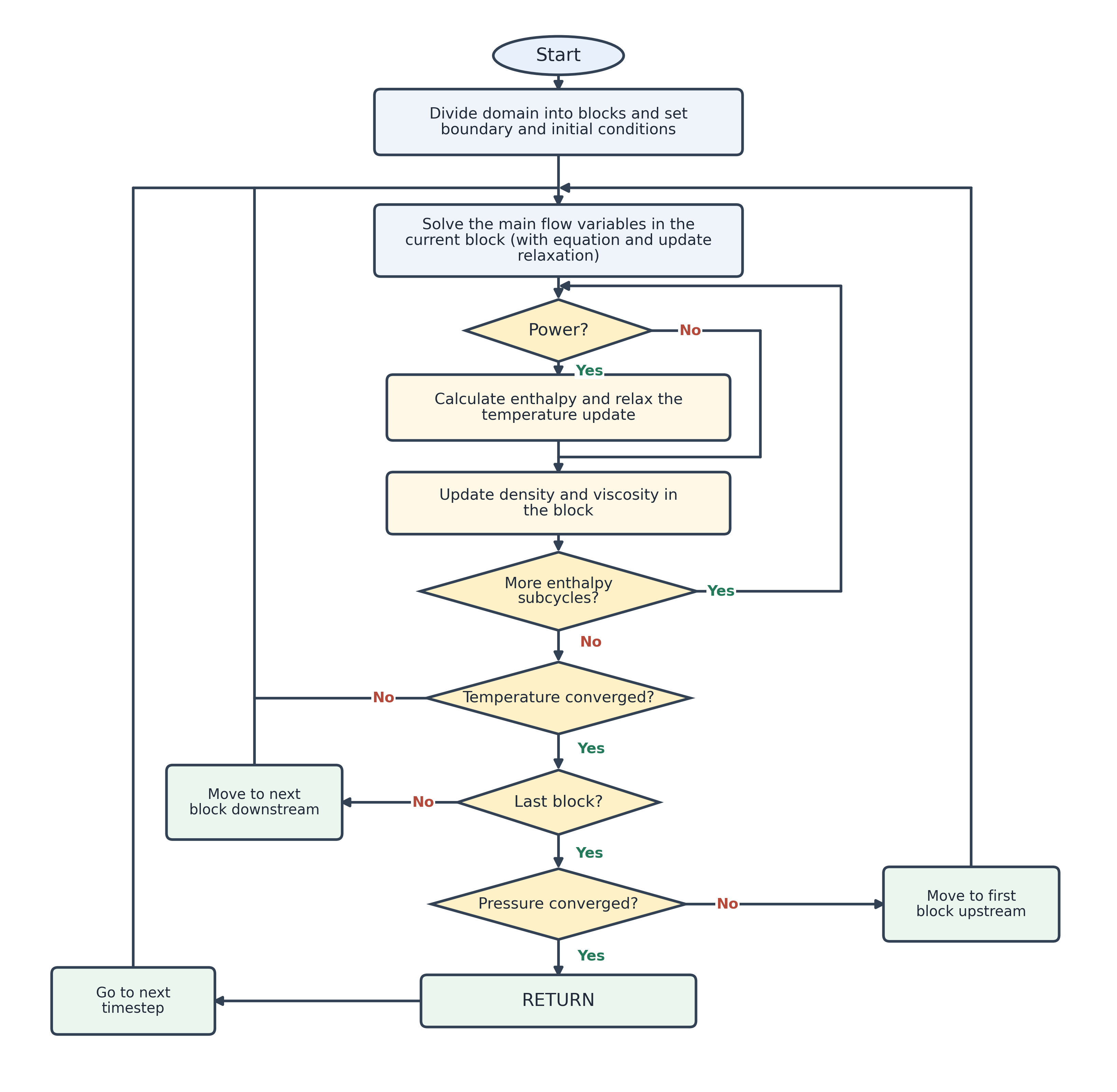

A hybrid numerical method of solving the subchannel equations was developed. Hybrid in this context means that the user has the option of solving each portion of the problem at a time, by dividing the domain into blocks. Each block is solved sequentially from inlet to outlet. The mass flow at the outlet of the previous block and the pressure at the inlet of the next block provide the needed boundary conditions. The essence of the algorithm hinges on the construction of a combined residual function based on the lateral momentum equation. To solve this equation a Jacobian Free Newton-Krylov type Method (JFNKM) was used. The workhorse of the code is the non linear equation solvers (SNES) found in the Portable, Extensible Toolkit for Scientific Computation PETSc.
(13)
The main unknown variable in this non linear residual is the crossflow . The combined residual function calculates the non linear residual after it updates the other main flow variables, such as mass flow , turbulent crossflow , pressure drop and pressure , using the current as needed. So every time this function is called by the Newton solver the flow variables get updated. This affords the solution of all flow variables at the same time. is the local pressure minus the exit pressure, , so at the exit is zero. The hybrid algorithm is presented in Figure 3.
SCM hybrid numerical scheme
Figure 3: SCM hybrid numerical scheme
Once the main flow variables converge in a block, the enthalpy conservation equation is solved and enthalpy is retrieved in all the nodes of the block. In the special case where no heat is added to the fluid in the block, the enthalpy does not need to be calculated in that block (unless there is a non-uniform enthalpy inlet distribution). Using enthalpy, pressure and the equations of state, temperature and the fluid properties such as density and viscosity are calculated. After the fluid properties are updated, the solve is repeated until the temperature field converges. Once the temperature solution converges the procedure is repeated for the next block downstream. Once the temperature solution converges in all blocks we check to see if pressure has converged in all blocks. If not, we repeat the procedure starting again from the first block, until pressure has converged. Note that in order for the pressure information from the outlet to reach the inlet, it will require a number of the pressure loop iterations equal to the number of blocks. Last, the calculation of the flow variables and of the residual is done in an explicit manner.
